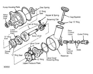

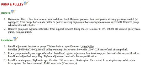

1. how do I R&R a power steering pump with step by step instructions
2. what special tools do i need
3. what additional items do i purchase like hoses, fittings, clamps
4. there are 2 different models avail after market how do i determine which one is right

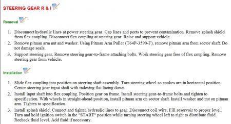

5.how do i change out the power steering gear box with step by step instructions
6. how difficult
7. what special tools do i need (to buy)
