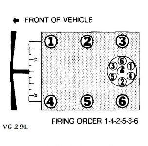

Someone removed part ofthe spark plug wires from my Ranger and I do not know the order to replace them. Could you provide me a diagram to show the proper order to hook the wires from the distributor cap back to the plugs. This Ranger has a 2.9 FI engine , 4 wheel drive and a 5 speed. Thank you

https://images.2carpros.com/forum/automotive_pictures/99387_ranger_29_1.jpg
good luck
