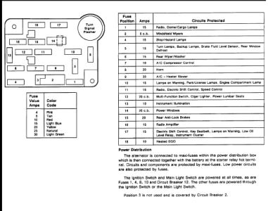

1. Fuse diagram...which fuse is the horn?
2. If its not the fuse, other suggestions?

Hello I have attached the fuse chart for you. Make sure you just don't take the fuse out and look at it. Use an ohm meter or replace it. It can be hard to see unless it is clearly blown. You can also run wires from your battery and touch the horn connections. If it blows, then the horn is good and we would have to go from there. Hope this helps.
