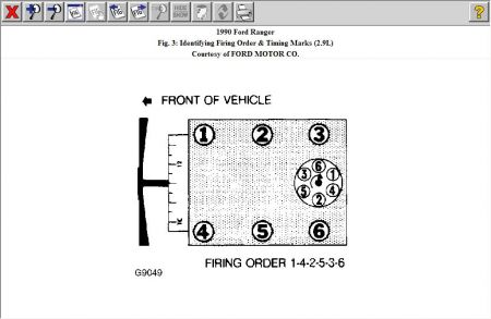

1990 Ford Ranger Spark Plug Wire Order
BLOWENUP
i need to know what order to put my spark plug wires back on my distibutor cap? i already put a new cap on i just didnt remember how to put the plugs back . i would appreciate it if you have a visual copy . thank you :oops:

What's the engine's liter?
Oct 20, 2007 at 8:36 AM
BLOWENUP
it is a 2.9 liter engine with 6 cylinders
Oct 21, 2007 at 2:58 AM
  • 75,988 POSTS
See below
https://images.2carpros.com/forum/automotive_pictures/12900_Ranger_1990_firing_order_1.jpg
