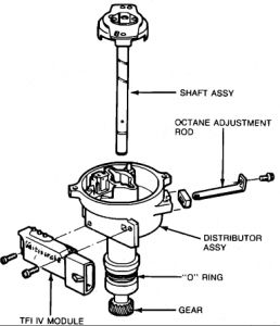

How in the world do you pull the distributor out of that thing, if it is behind and below the Fuel Injection Manifold Assembly?
Do you have to remove the fuel injection assembly first?
thanks

Hello I have provided the info your requested on how to remove the distributor. The directions do not say you have to remove the FI first. Also, looking at your information on your engine, it doesn't make sense to me. 1986, Ford Truck, Ranger, 2WD, the 4 cylinder is a 2.3L DSL Turbo and a 4 cyl 2.3L SOHC - the 6 cylinder is a 2.9L I have attached how to change.
https://images.2carpros.com/forum/automotive_pictures/248015_1_39.jpg
Disconnect primary wiring connector from distributor. Mark position of No. 1 wire tower on distributor base. Remove distributor cap and adapter and position aside leaving wiring attached. Remove rotor to prevent damage. Remove TFI connector. Remove distributor hold-down bolt and clamp. Remove distributor. On vehicles equipped with security-type hold-down bolt, use tool T82L-12270-A or equivalent to remove hold-down bolt. Turn engine until No. 1 piston is on compression stroke. Align timing marks to proper initial timing. Turn distributor shaft so rotor tip is pointing toward mark made in step 2 on distributor base. Continue turning distributor shaft slightly so leading edge of vane is centered in switch stator assembly. Rotate distributor in engine block to align leading edge of vane and vane switch and verify that rotor is pointing at No. 1 cap terminal. If vane and vane switch stator cannot be aligned by rotating distributor in engine block, pull distributor out of block enough to disengage distributor and to engage a different distributor gear tooth. Repeat steps 9, 10, and 11 as necessary. Install distributor hold-down bolt and clamp without tightening. Connect distributor TFI and primary wiring harnesses. Install distributor rotor, cap adapter, and cap. Using timing light, set initial timing according to specification given on Vehicle Emission Control Information Decal. Torque distributor hold-down bolt to 17---25 ft. lbs. Recheck timing and adjust, if necessary.

I had posted the question based on information supplied from a friend. It is a v 6 with fuel injection. No wonder I could not find a v6 2.3l in the book, haha. The distributor is way in back, underneath, and behind the fuel injection assembly. I did hear from one other Ford Repair Technician. He indicated to me, the fuel injection assembly had to come off to get to the distributor for removal. I know that you are going by the book there. Since I had the wrong motor, it was difficult, but thanks, I appreciate the diagram, too, thanks again. David

You may end up having to remove certain things the book doesn't call for. HOWEVER, the rule is never remove more than you need. It may be harder and take a little longer but the less you take apart the less you take a chance of damaging something, needing more seals, gaskets, creating additional problems etc.
Then agian sometimes you look and say, hey, if I pull this I will save 5 hours getting to that. It must be weighed out........
