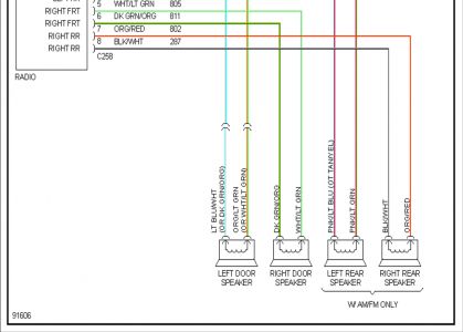

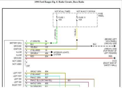

i am trying to install an after market stereo and dont have a clue what color wire is what
Wednesday, February 18th, 2009 AT 2:30 PM
IMPALASS
MECHANIC
3,112 POSTS
Hello -
Here is the wiring for the radio. . .. . ...you will have to print and overlap. . ...I had to split so you could see it.
