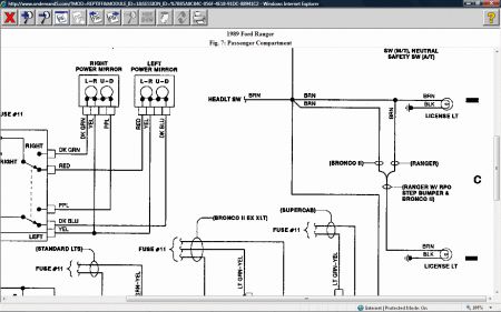

license plate wire has been cut. Where does it conect back to

The brown wires go back to the headlight switch, the blacks are ground and can be grounded at and body metal point.
