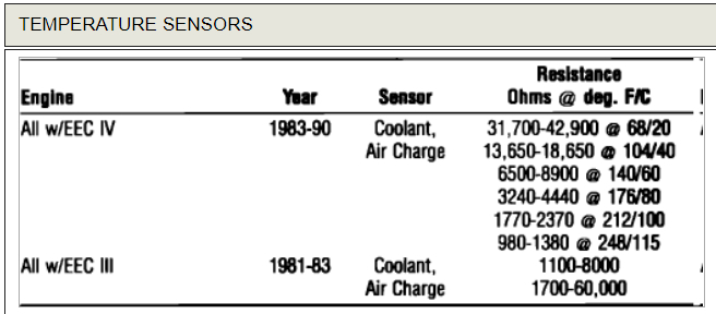

This sounds like a classic engine coolant temperature sender that is not working right.
Here is a guide to help you see what you are getting into with the repair.

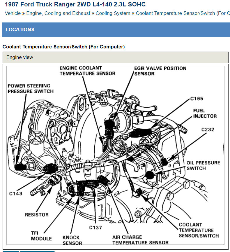

Here is the location for your car which is near the upper coolant hose outlet for the 2.9 and here is for the 4 cylinder engine.
