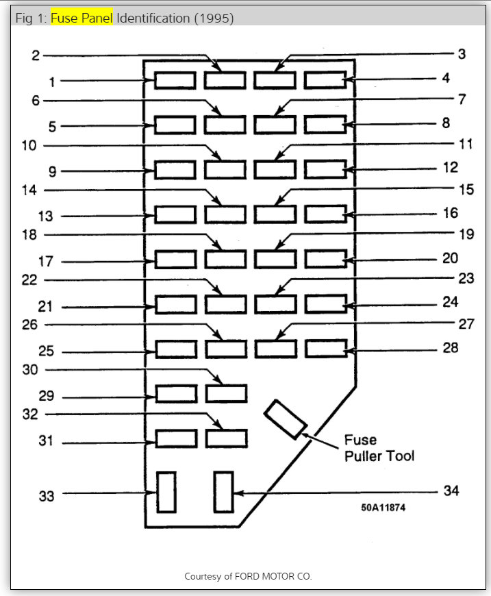

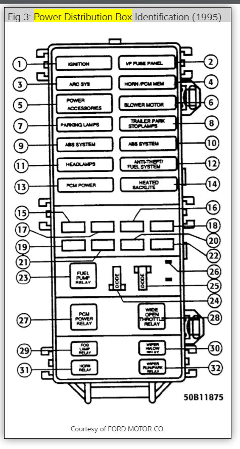

This sounds like an PCM relay is overheating and shutting down check the relay to see if it is hot which is an indication for failure.
Here is a guide to help you test it.
Here is the relay location.
Cheers
