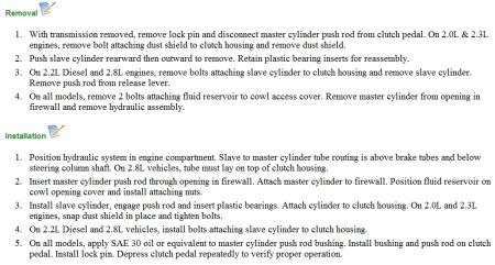

i have an external slave cylinder on my ranger. it has no bolts and i am trying to figure out how to remove it.
