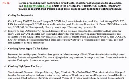

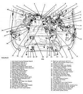

Where is the temp switch that regulates the engine radiator electirc fans... I have straight wired and put a manual switch in to get by : ) they both work .. I check fuses and relays they all are ok ,,, so I am thinking it must be a temp swith? but where is it? Anybody know

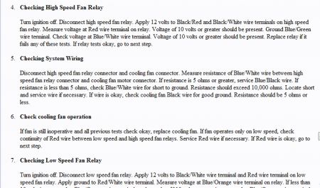

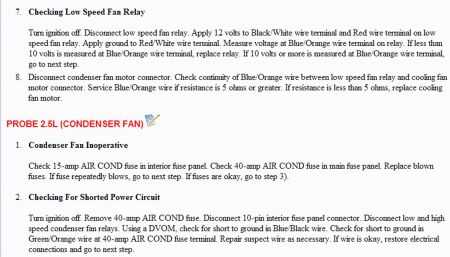

It's controled by two relays and the PCM here's the locations and tests!

For more info follow the Mitchell link...
