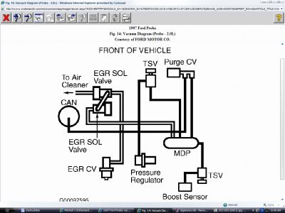

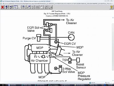

I need to get my Midas mechanic a diagram for the vacuum hoses in the Probe.
The current ones have been cut - cut off - and plugged, so that the car is running badly.
The MAF sensor/EGR/and selenoids have been replaced.
The vacuum hoses are in bad shape, but he doesn't know how they are laid out in the Probe.
PLEASE HELP ME - PLEASE - I need my car to get back and forth to work. Bless You
Jul 25, 2008 at 3:45 PM
MERLIN2021
  • 17,250 POSTS
Here you go top is 2.0 4 and bottom is 2.5 6
