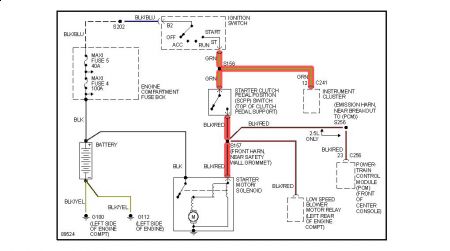

For a start load test the alternator might not be reconditioning the battery and also recheck battery connection make sure the posts/cables are cleaned and shiny and properly tightened. If it continues could be the starter, clutch switch, and ignition switch.
https://images.2carpros.com/forum/automotive_pictures/12900_probe_start_circuit_2.jpg

There was a lot of buildup around the battery terminals.. cleaned that up..
Also I found that the ground wire was loose where it connects to the car's body..
After some more research I found that the clicking was most likely just another symptom of a low battery.
Seems to be working just fine now, thanks for the help!
