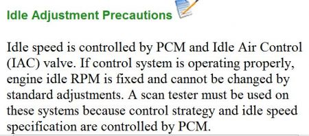

I think the car idle is too low. What should the idle speed be and how can it be set?

Hi there, Idle speed is 650-750 RPM,
