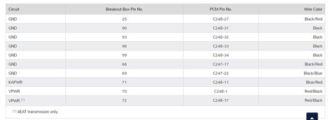

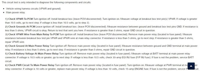

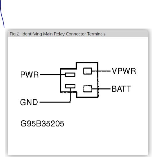

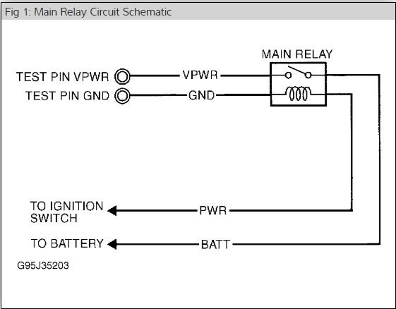

I need to go to circuit test b please?
Feb 9, 2020 at 4:38 PM
MOTOR MASTER
  • 279 POSTS
Hello my name is Dave,
I've attached the circuit test you are looking for. I hope it helps.
