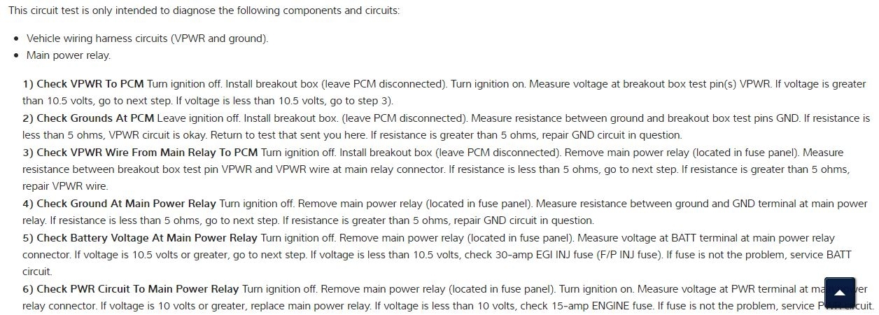

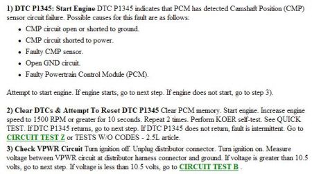

I recently purchased a 1997 Ford Probe GTS. On sunday, 9/20/09, i washed the car and pressured washed the engine like i do on all my other cars without any problems. Well, it stop working on sunday after i pressured washed the engine. I ran a scan and i got the code P1345. What do i do to fix this problem?

Perform tests below..let me know what further steps your results lead to.
https://images.2carpros.com/forum/automotive_pictures/261618_Noname_1002.jpg

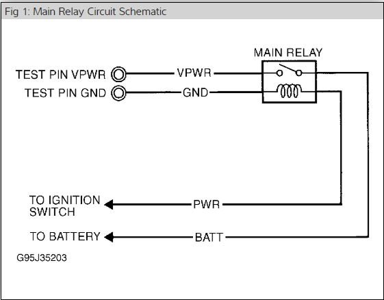

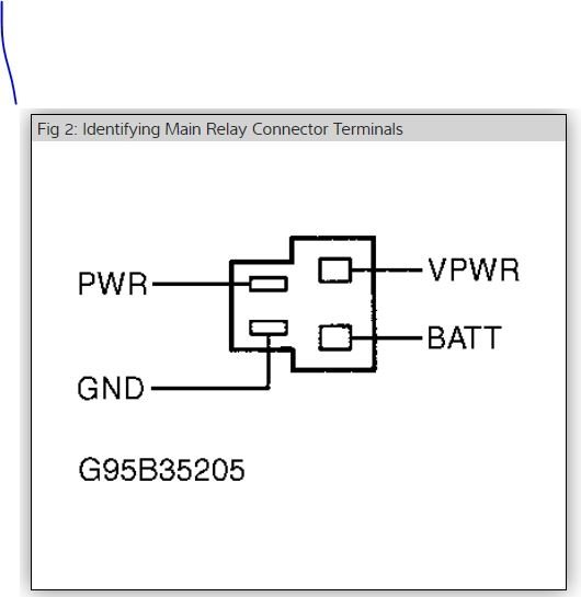

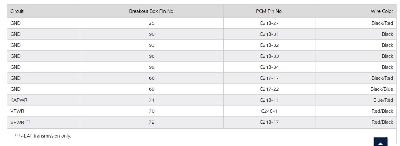

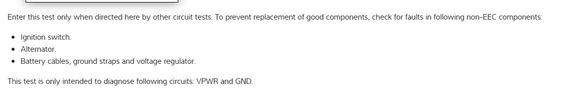

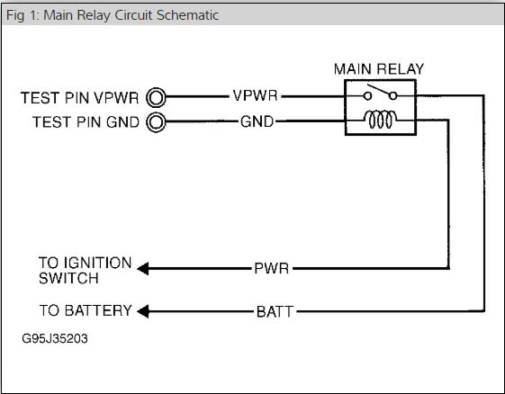

I need to go to circuit test b please?
Feb 9, 2020 at 4:38 PM
MOTOR MASTER
  • 279 POSTS
Hello my name is Dave,
I've attached the circuit test you are looking for. I hope it helps.
