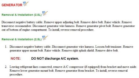

how do i remove the alternator. cant seem to get to it.

https://images.2carpros.com/forum/automotive_pictures/261618_Noname_997.jpg
