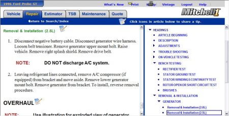

How To Change The Alternator?
Nov 1, 2007 at 11:39 AM
Experienced Mechanic
75,988 POSTS
See below
www. .com if you need a repair manual see below your post.
