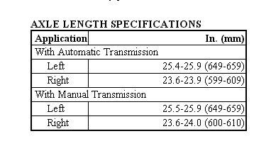

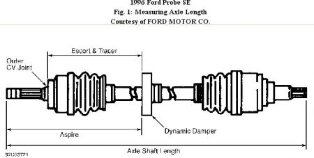

This car has gone thru 3 1/2 sets of axles in less than 2 years. Motor mounts & transmission are said to be fine. Purchassed all axles @ O'reillys Part store. Noticed theirs as being approx. 1 inch shorter on both sides as compared to specs in my car manual. Would appreciate any info You have! Thank- You. Kim

IF they are incorrect measurements, then take them back.
