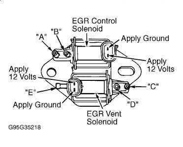

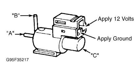

check engine light on for a couple days then off for a couple days about 2 months now codes p1195 (boost sensor)and p1402 (valve position sensor) can you help with locations and diagrams is the position sensor on the egr valve and the boost sensor on the air filter housing will 1 sensor set another off

2.0L or 2.5 L

its a 2.5 and I have manuels

Hi Both are located rear top center of engine. And yes either one fails can set code for other. Does your manual have instructions for testing EVP and Boost? See figures
https://images.2carpros.com/forum/automotive_pictures/198357_Graphic_81.jpg
https://images.2carpros.com/forum/automotive_pictures/198357_Grafic_3_18.jpg
Hope this helps
