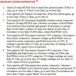

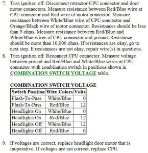

1995 Ford Probe head light
1995 FORD PROBE
147,000 MILES • 4 CYL • FWD • AUTOMATIC
COOKIE77205
the headlight dont pop up. this is a intermitten problem. you can turn the switch and the lights come on just dont pop up all the time right away. Is this a cylinoid issue or do you have a suggestion.
