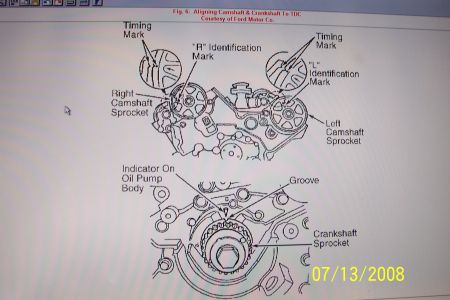

need to know why if i have all the timing marks lined up correctly why it is pushing out the intake but pulling in threw the exhaust like the strokes are flipped....... Is it possible i switched the cam gears when we did the head gasket? one is labeled L and the other one R, now would that be looking at the front of the motor left and right or sitting in the car as if it were a longitude mounded motor?

Here diagram of timing marks....
https://images.2carpros.com/forum/automotive_pictures/188069_94prob6cyl_1.jpg

thanks, i jsut put them on with l and r from as if i were looking at the motor, big help man thanks......

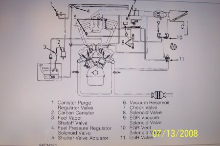

Here's the Vacuum..... Not sure if you can save pic then resize to read better.
https://images.2carpros.com/forum/automotive_pictures/188069_94probevacuum_1.jpg

CAFFINE1369
  • 9 POSTS
well the only one we can;t find is the one that goes to the rear head on the bottom side of it right below the throttle body. any ideas..... maybe a pic on the head will show it
Jul 13, 2008 at 1:54 PM
OBXAUTOMEDIC
  • 3,711 POSTS
[quote:079cc89460="caffine1369"]well the only one we can;t find is the one that goes to the rear head on the bottom side of it right below the throttle body. any ideas..... maybe a pic on the head will show it[/quote:079cc89460]
Can you post a pic of the area. I am drawing a blank right now.
Is the hose small. Do you have the hoses going to the throttle body that cool it?
Jul 13, 2008 at 2:11 PM
CAFFINE1369
  • 9 POSTS
yeah we have the ones that go to the throttle body and to the egr valve from them coolant top rad hose..... its jsut a steal nipple coming out of the end of the head and i'm not sure where it goes...... its been 8 months since we tore it down so i'm a lil confused now........ any help would be good help
