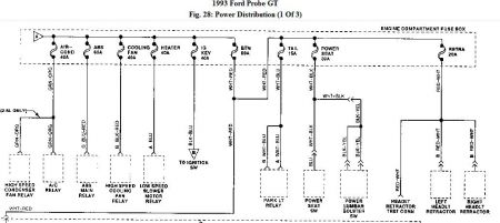

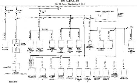

My sons Probe GT(used to be mine) sat for four months with a dead battery, outside in the weather. I replaced the battery and there isn't any power past the fuse box under the hood. I did a logic test and there seems to be power there, but nothing inside the cockpit. I thought it might be the ignition relay, but don't want to shell out 135 skins to find out for sure.

Thats the problem, no juice past the primary fuse box.. the cockpit is dead.. No alarm or keyless entry installed...Dome light or courtesy lights don't even come on.. Thanks for the reply...T

sorry didn't get back to you sooner .. had problems with my computer !! have you checked with voltmeter for power (black/blue wire) @ ignition switch ? I'm thinkin is the switch faulty ? if no pwer going to the switch .. first place to check is fuses .. which obviously you have already checked .. then the wiring underneath the fuse box ? let me know
