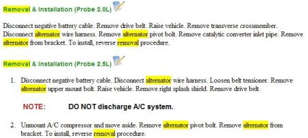

I am a novice who has basic automotive tools, but no speciality tools. Can I replace the alternator in my Probe without speciality tools; and if so, what are the proper steps to do it?

Hi there,
You should be able to do this yourself, see text for details on removal.
Mark (mhpautos)
