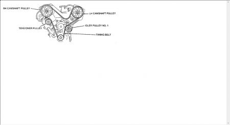

i have a ford probe 93 GT, it will stat but as soon as it does their is a lot of smoke that comes out of the timing belt cover. Also when its starting their is a kind of screeching noise. any ideas as to what it could be?
thanks!
Mar 16, 2010 at 6:24 AM
  • 75,988 POSTS
Hi josefvb, Welcome to 2carpros and TY for the donation You need to open up the timing belt cover-smoking could mean alignment problem causing it to rub against something in there or tensioner and idle pulley locking -up
