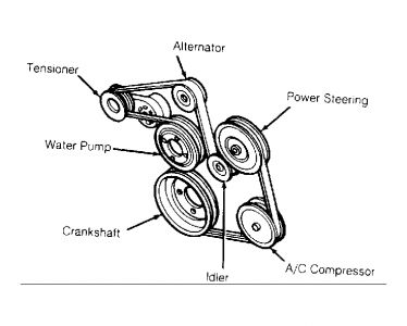

how can i repair the driving belt? can i please get a scheme?

Hi there, Serpentine belt set up as per pic. Mark (mhpautos)
