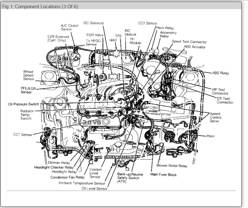

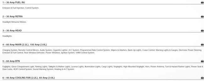

I am looking for the Headlamp relay on my 1990 Ford Probe, Ford can not help me and the autoparts store says it is located on the passenger side on the radiator support, but it is not there. The dims do not work but the brights do. Please help I need the lights to drive.
Jan 22, 2009 at 3:49 AM
DOCFIXIT
  • 18,828 POSTS
Hi
Relay is on left side,passenger on the radiator support .Forward of washer reservoir. There are three the first one is the dimmer relay. Next one head light
Check the last image show the headlight relay location
Hope this helps
