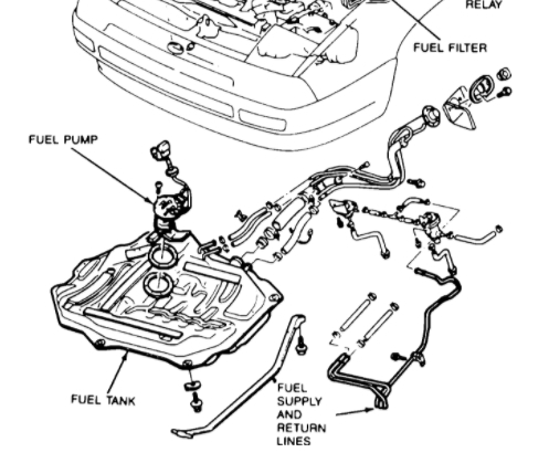

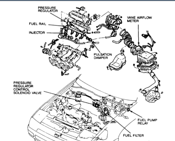

Need to know where the fuel pump relay is is this car listed above with a V6.

Fuel injector circuit is controlled by fuse #1 Underhood fuse block. Relay as seen in picture.

Hello, I'm Danny.
If you have a Ford Probe like in this old post it is an in tank pump that mounts inside the fuel tank. Here is a guide to help test the relay:
I've attached 2 pictures below of the fuel system. Hope this helps and thanks for using 2CarPros.
