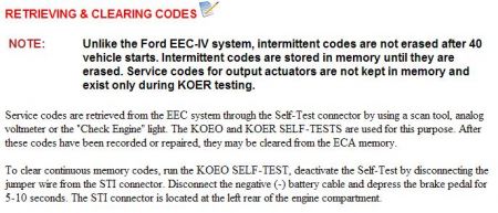

how do you get the trouble codes for a probe

https://images.2carpros.com/forum/automotive_pictures/261618_Noname_1355.jpg
