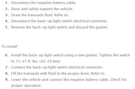

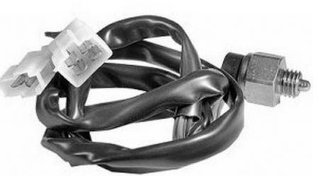

My reverse lights stay on all the time.
started with gear shift in drive then it is now on when the car is in neutral
can u please help me

Hello, take a look at the neutral switch, may need to adjust the shift cable.

https://images.2carpros.com/forum/automotive_pictures/170934_ford_probe_1.jpg
My bad, I don't know why I thought you had an automatic, it says manual on your post. Check the back-up light switch. Below is the partsbook picture.
https://images.2carpros.com/forum/automotive_pictures/170934_probe_backup_light_switch_1.jpg

i thank you very much for responding so quickly for i am eagarly awaiting your replys
But as far as the pic u sent where am i suppose to find that?
By the way did tht pic come from something that i am able to see online i tried to find a free online manual for 1989 ford probe turbo with no success

https://www.2carpros.com/articles/mitchell1eautorepair-car-repair-manuals
I don't know if the above link will work, it came from the site. I don't have a good picture of the location. I'd look at the bottom of the transaxle or close to the bottom.
