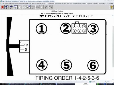

I NEED: Fire order V6 4.0L
Rotor to plug fire order???
I messed up when I changed. I used Bosch preamen plugs, would that cause a problem?

terry tell me year and make of vehicle

You did not even tell us what Make or MODEL? Year would be good too...I will tak a look into my Crystal ball...it's a Ford!
https://images.2carpros.com/forum/automotive_pictures/62217_FiringOrder_4.jpg
