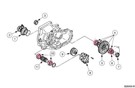

I think that that could be somewhere in the transmition but the funny thinngs are:
- It couldn't be the wheel ball bearing (i think) because I heard what that sounds like - its much louder and irregular depending on the road surface, turns etc... This is a continuous noise without changes
- I don't see how could it be the gear box because it's heard in neutral or clutch down..
- A damaged or unlubricated Differential maybe? But I don't see what might have caused that... And the oil in the differential was changed recently...

As long as the wheels are spinning, yes! pull the plug, the fluid level should be level with the bottom of the plug hole.
Sep 9, 2007 at 12:56 AM
MERLIN2021
  • 17,250 POSTS
SECTION 307-01: Automatic Transaxle/Transmission 1998 Escort/Tracer Workshop Manual DESCRIPTION AND OPERATION Procedure revision date: 03/05/1998 Disassembled Views —Differential Components Differential, Exploded View Item Part Number Description 1 7A108 Torque Converter Stator Support 2 7F401 Converter Impeller Hub Seal 3 1777 Differential Seal 4 — Differential Bearings 5 4026 Differential 6 — Shim 7 1177 Differential Seal 8 — Bearing Housing 9 7F475 Idler Gear 10 — Output Gear Bearings 11 7060 Output Gear This is 98 Escort Tracer, but should be similar to yours...
