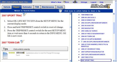

I had my oil changed a the ford dealer (who are idiots) and they forgot to reset my oil change light. How can I reset it?

Follow the instructions below
https://images.2carpros.com/forum/automotive_pictures/12900_reset_oil_light_1.jpg

I still get the engine oil needs to be changed.

Sir
Take it back to the dealer and speak to the SM see what can be done with a job that is paid for and was not performed properly.
As for the instructions that's all I got to clear the light-maybe something else is going on that you and me don't know. Could they have done something stupid?????
