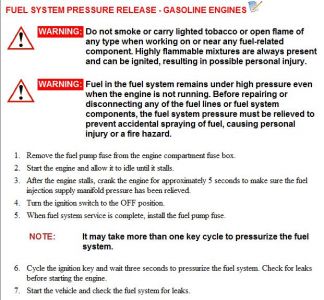

HOw do I relieve the fuel line pressure on a Econoline e350 box truck to change out the fuel filter?

https://images.2carpros.com/forum/automotive_pictures/261618_Noname_2426.jpg
