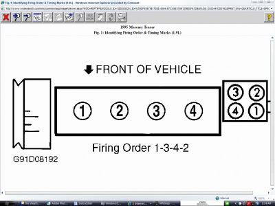

I need the firing order to the spaek plug coal pack.
We have a Mercurey Tecer Trio 1995 Model
Sunday, December 30th, 2007 AT 12:17 AM
MERLIN2021
MECHANIC
17,250 POSTS
4 cylinder Fords are usually 1-3-4-2 For 1.8 and 1.9 engines...diagram...
