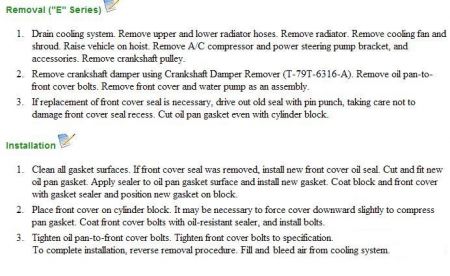

how do you change a timing chain gasket step by step on a 1991 ford club wagon with a 5.0 engine?

Aug 11, 2009 at 2:04 PM
