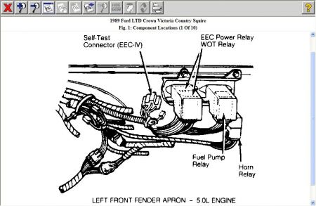

im trying to replace the fuel filter in my 1989 Ford country squire wagon. I need to depressurize the fuel system first and cant find the fuel pump relay. Can someone please tell me where it is and how to shut off the fuel pump? Thank you

See below
https://images.2carpros.com/forum/automotive_pictures/12900_relay_8.jpg
