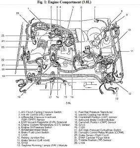

Electrical components on 3.8:
https://www.2carpros.com/forum/automotive_pictures/576_Mustang_2000_1.jpg
Let us now how are you doing it...
Good Luck!
