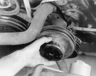

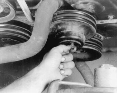

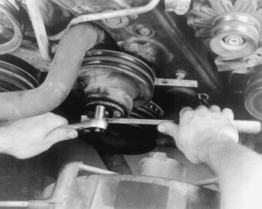

After removing the drive belt, loosen the water pump pulley's bolts.
Remove the pulley attaching bolts.

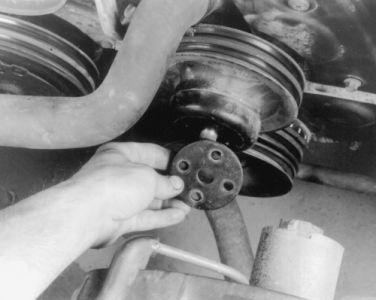

Remove spacer if equipped
Remove pulley

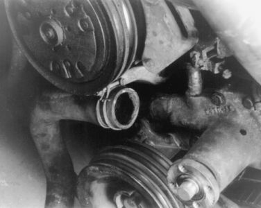

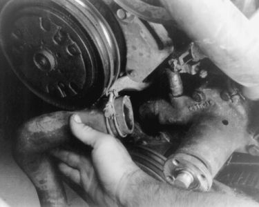

Loosen hose clamp and remove lower hose
Inspect hose replace if needed

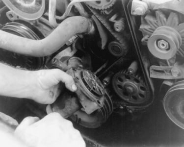

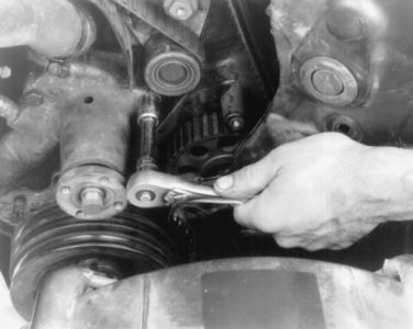

Loosen and remove water pump bolts
Remove water pump
Sorry, photo's from 4cylinder it's the only photo's I have but should give you a good ideal. If I find 8cylinder photos I will post them later. Hope this help's. Fairracing31
