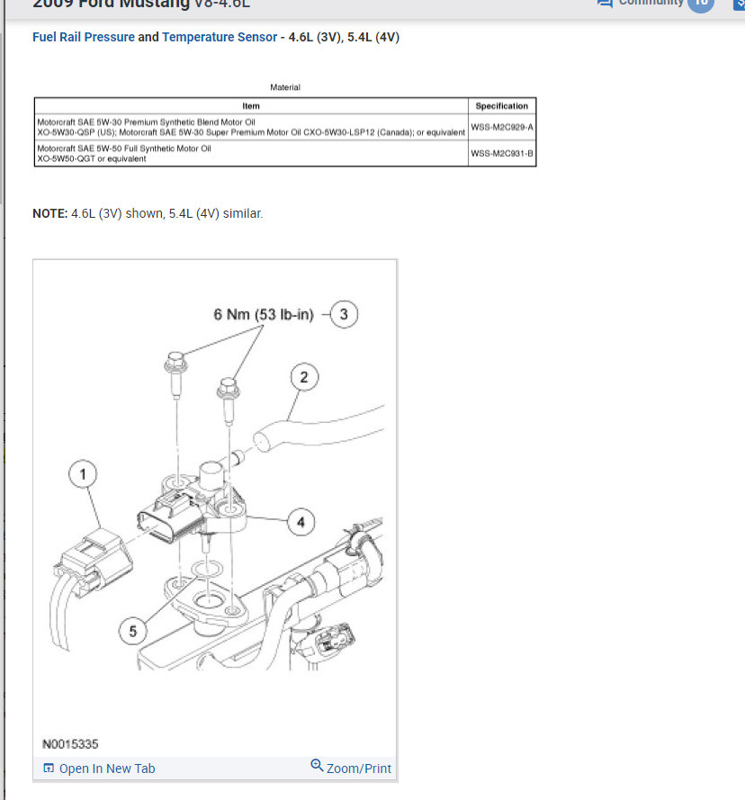

I ran the gas tank down to 10 miles before empty. I had car in Driveway. Tried to pull out of driveway and car stalled. Thought I was empty, so I purchased gas in a can and put 10.00 worth. Car will start then after 10 seconds it will turn off. Purchased a fuel pressure sensor but I cant find it.
Oct 23, 2010 at 8:46 PM

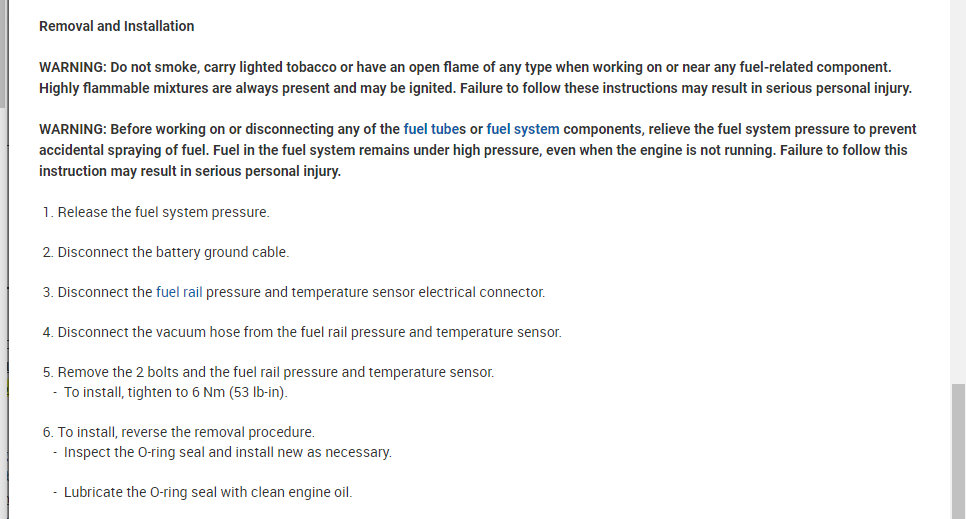

We can help with this. Please see the info below that shows the process on how to replace this.

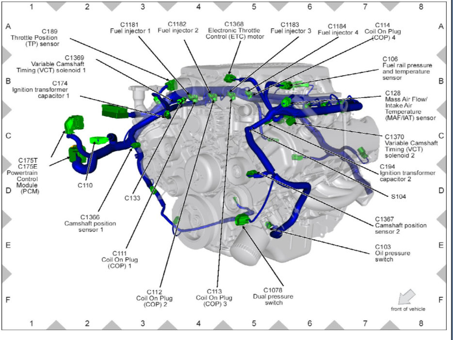

Plus there is a location view that will show where it is.
Please let us know if there are other questions. Thanks
