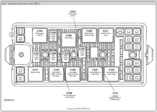

where is the starter relay on my vehicle
Jan 8, 2010 at 2:41 PM
  • 75,992 POSTS
Its in the bussed electrical center
https://images.2carpros.com/forum/automotive_pictures/12900_relay_27.jpg

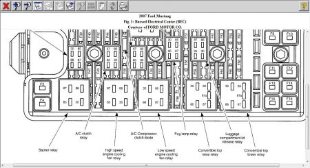

THAVENS76901
What side of the starter relay does the positive wire go. There are also some other wires and I don't know what side of the relay they go on. I took these off years ago and don't remember how they go back on.
Dec 18, 2020 at 2:21 AM (Merged)
HMAC300
  • 48,601 POSTS
when mounted on fender well the side closest to battery there should be one large wire going to the starter. the other wires should go to battery positive and the red/ltblue wire will go on small post closest to battery so relay will activate to start car.
