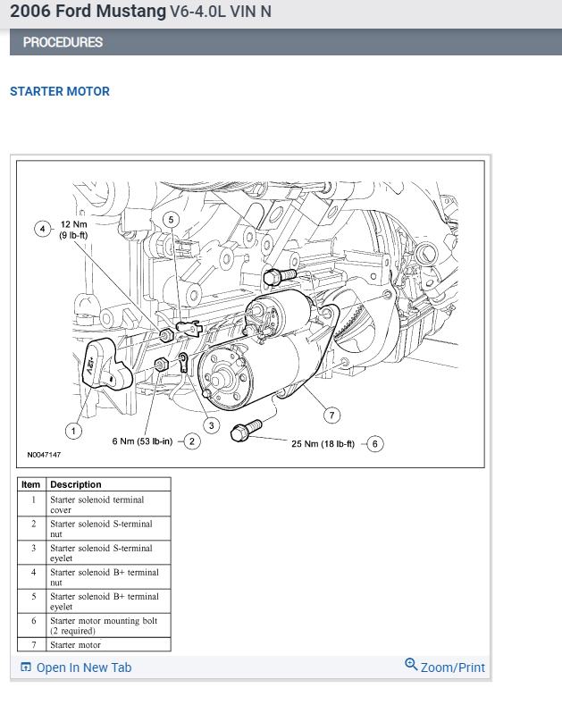

My car has very low mileage, just tried starting it and, the engine wont turn over, just makes a clicking sound, not sure what it is?Alternator, cellinoid?Starter?Please help

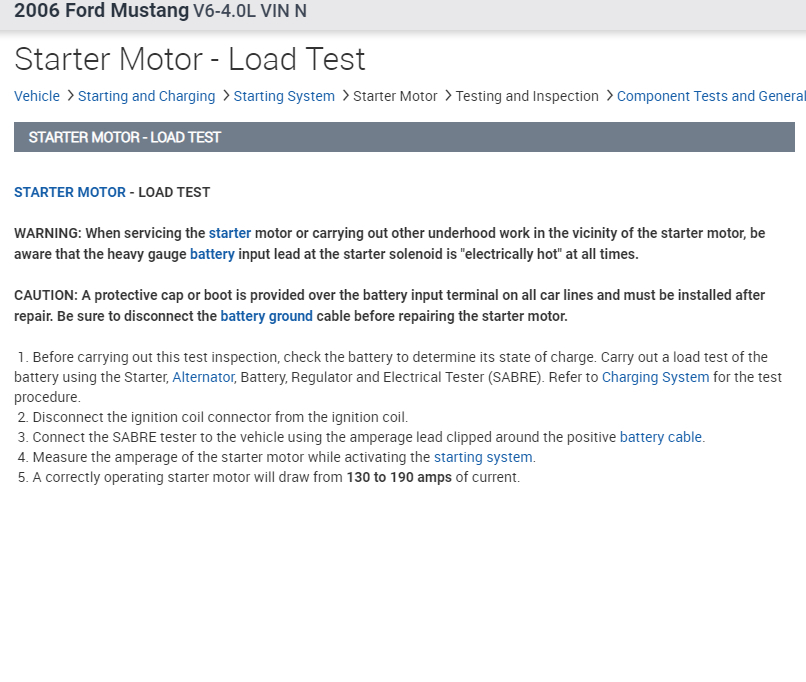

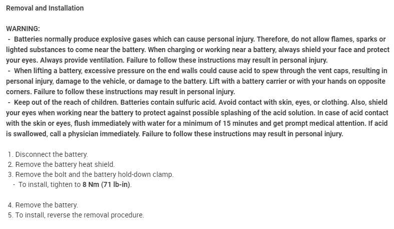

Just so we cover the basics. Have you tried to jump start the vehicle?

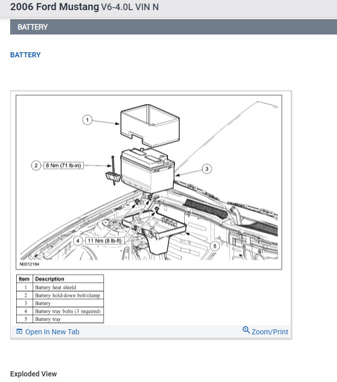

When the battery gets weak it can have the same issue as you are facing. It will make the clicking noise at the starter but will not have enough power to crank over the engine and start it.
https://www.2carpros.com/articles/how-to-jump-start-car-battery-using-jumper-cables
If you are able to jump start it and the engine stays running normal, then the battery needs to be replaced.

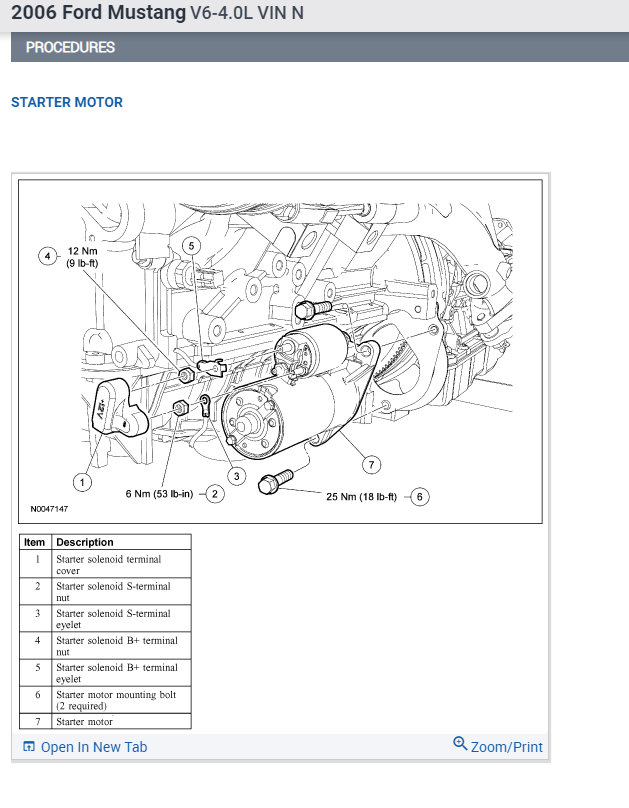

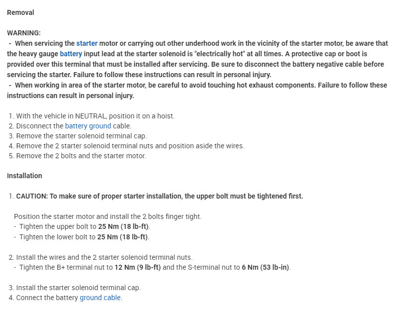

If the jump start is unsuccessful and you still just get the click, then it could be a faulty starter. It can also be a wiring issue to the starter. First make sure the wires are secured and free of corrosion.
Here is a helpful guide:

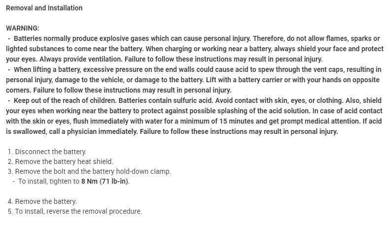

I have attached the battery and starter replacement procedures below.
