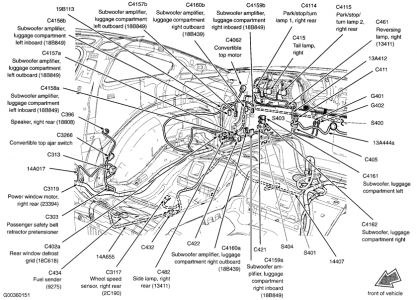

I am trying to find out where the fuel sending unit is located and if it can be replaced easily.

fuel sender is located under the right rear of the vehicle
https://images.2carpros.com/forum/automotive_pictures/261618_Noname_2248.jpg

THE BACKSEAT IS HELD IN PLACE BY TWO CLIPS AND THAT IS IT. IF YOU TAKE THEM OUT, YOU CAN SEE THE OPENING TO THE FUEL TANK WHERE THE SENDING UNIT IS WITH OUT HAVING TO DROP THE ENTIRE FUEL TANK!!!
