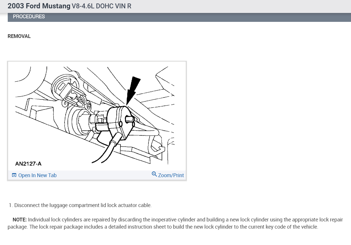

how can I get into trunk of car if lock doesn't work? Do back seats fold down?

how to remove trunk lock assembly?

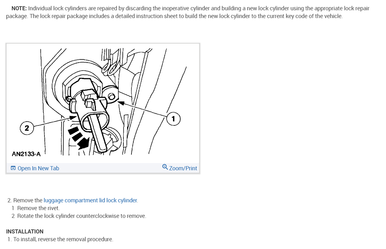

to remove the lock cylinder for the trunk lid, you disconnect the trunk lid lock actuator cable. then remove the rivet that holds the lock cylinder. rotate the cylinder counterclockwise and remove it. Check out the diagrams (Below). Please let us know if you need anything else to get the problem fixed. Remove the rear seats to get to it if you cant get the trunk open. You must drill the rivet out.
