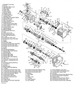

2004 Ford Mustang V8 Two Wheel Drive Manual 65.000 miles
I have a 2004 Mustang Gt with a T45 tranny that needs new shift forks installed, Im looking for a write up or workshop manual with directions but haveing trouble finding any info, any replies appreciated Thanks!

Thanks for the reply, tho the car is an 04 it has a t45 tranny in it, I think who ever had it before hand replaced the transmission with an older 99 unit. Ive found some views and from what ive seen the entire transmission needs to be dissasembled to repair the forks.

Ok I see, Well I do have some info on that trans and replacing shift forks in it. The transmission does have to come out of the vehicle to replace the shift forks. Let me know if you want the info on replacing shift forks in that.

Here is a exploded veiw of the trans, I have a few more pictures and some text if you would like them all let me know and I will send them to your email.. Good Luck!
