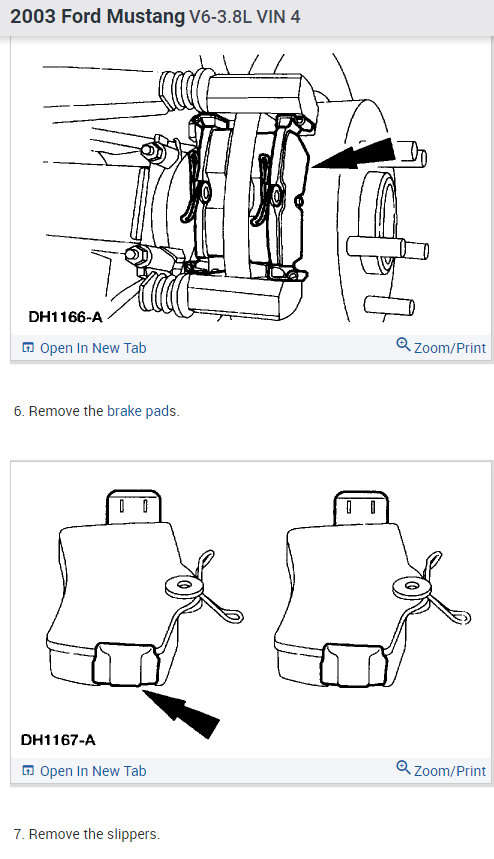

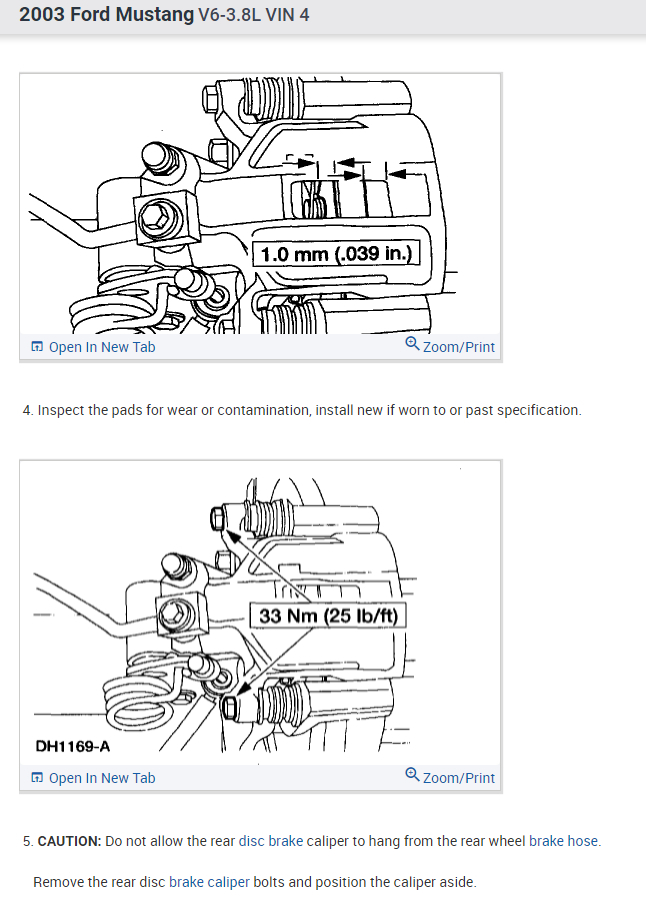

what is wrong when the caliber to retrack to put the new pads in
May 24, 2008 at 6:31 AM
LEGITIMATE007
  • 5,121 POSTS

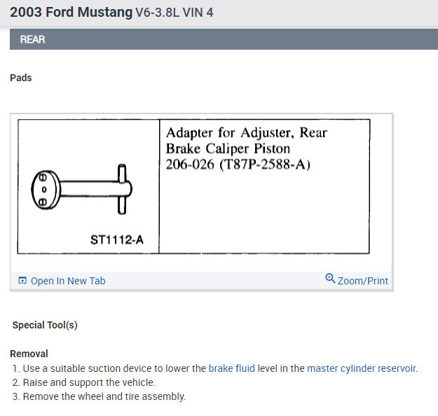

always make sure that your master cylinder is open so the fluid has a place to relieve itself when you push the cylinder in. plus video will help.
this will show ho to retract the caliper
https://youtu.be/j8YwfSKEzZo
let us know
Mar 8, 2021 at 5:10 AM
SQM
  • 6,383 POSTS

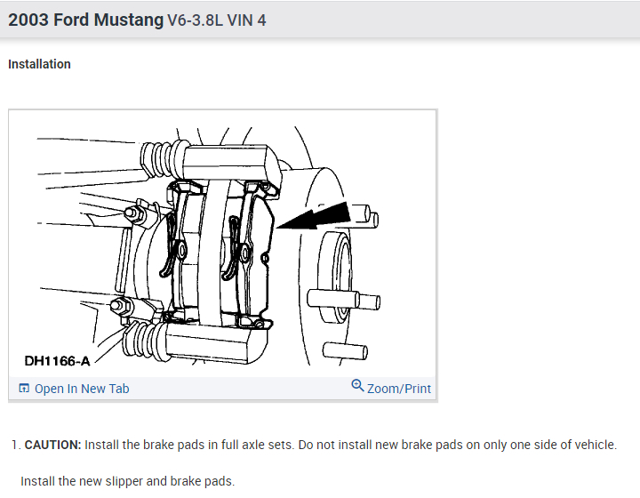

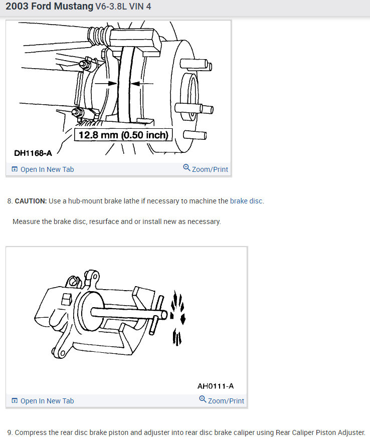

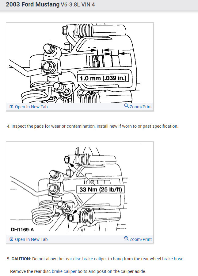

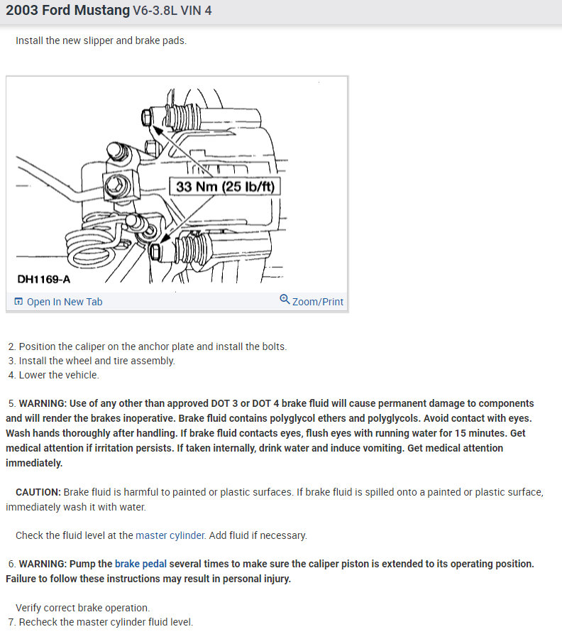

In order to retract the rear caliper piston, you will have to use a special tool.
This tool will line up with the notches on the face of the piston. Then you will have to turn the handle of the tool to retract the piston back into the housing.
Here is helpful video:
https://www.2carpros.com/articles/how-to-replace-rear-brake-pads-and-rotors
I have attached the pad replacement and piston retract procedure below.
