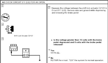

Stuck in park gear and cannot move shift lever. The button to release the gear shift will not go in, even when pressing hard on the brake pedal. Is there a manual release for the gear shift and how do I release it so I can get it moving and fixed?
Jul 7, 2009 at 4:36 AM
MERLIN2021
  • 17,250 POSTS

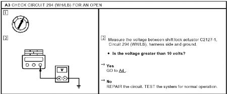

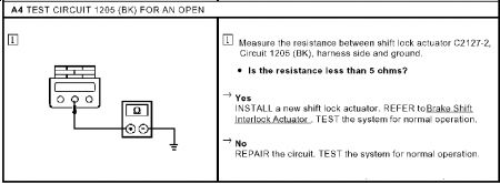

Here are the steps to fix it:
https://images.2carpros.com/forum/automotive_pictures/62217_1_12.jpg
https://images.2carpros.com/forum/automotive_pictures/62217_2_12.jpg
https://images.2carpros.com/forum/automotive_pictures/62217_3_16.jpg
https://images.2carpros.com/forum/automotive_pictures/62217_4_9.jpg

Thank you for the fix information, but is there a way to manually release the gear shift? How do I do this so I can take it to get it fixed?
Jul 8, 2009 at 3:36 AM
MERLIN2021
  • 17,250 POSTS
The simplest check is do the brake lights work? If not, it's a 20.00 BOO(brake on off) switch at the brake pedal...
