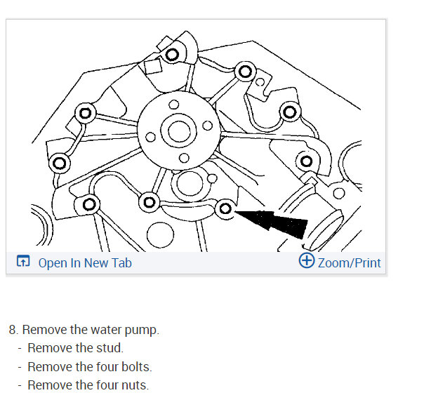

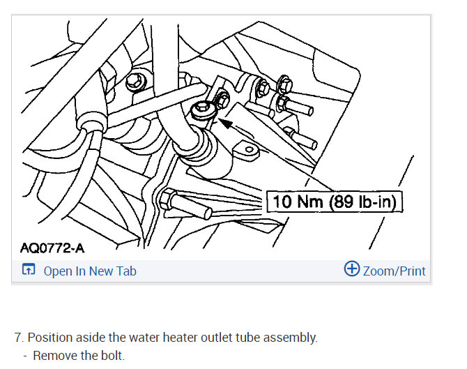

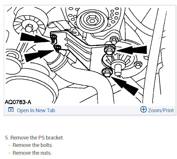

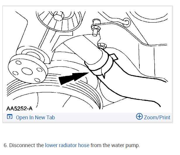

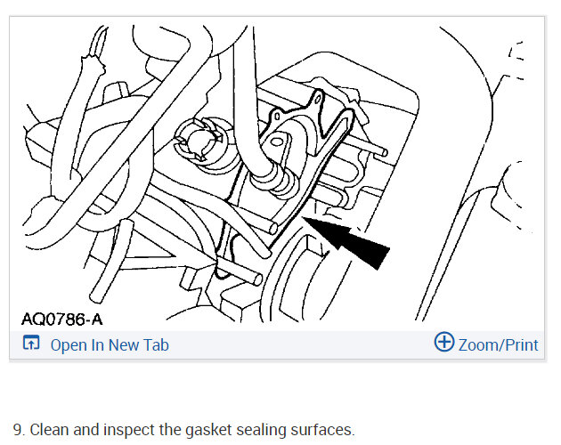

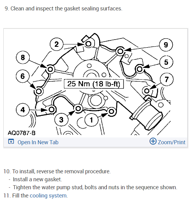

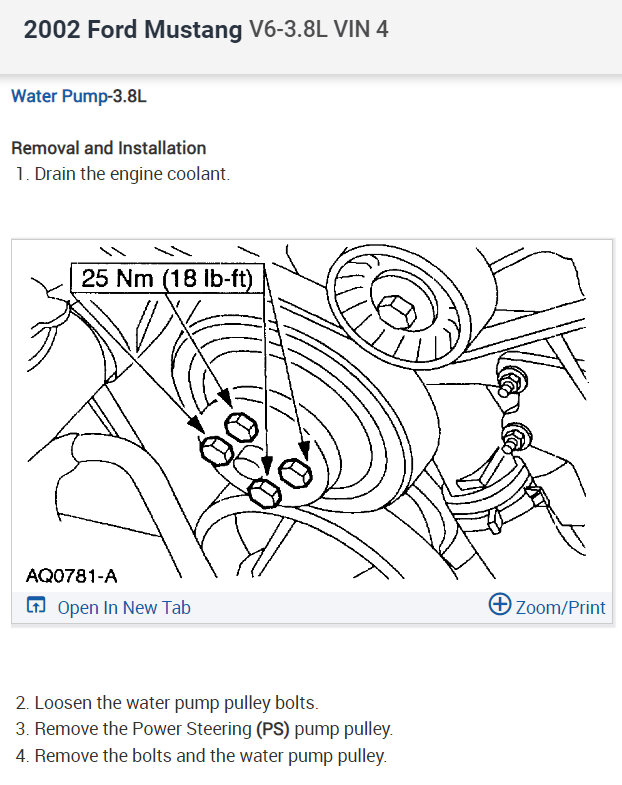

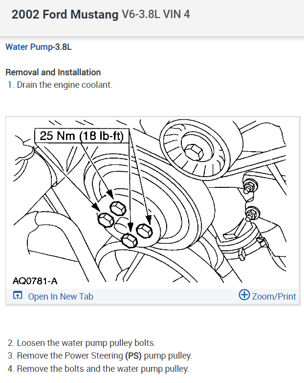

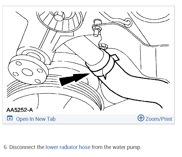

It sounds like the water pump is leaking which is common, here is a guide to help you pinpoint the leak and I have included how to change the water pump out in case you need it.
https://www.2carpros.com/articles/car-is-leaking-coolant
Check out the images (below). Let us know what you find.
