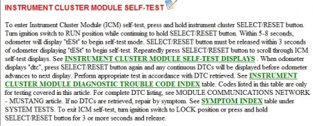

This morning I had to boost the battery on the Mustang to start it. When I got in and had driven a few blocks I checked my speed and speedo was sitting at 120 mark, not moving. The other gauges work fine, speedo was working yesterday What's the fix?

use the steps below to get the gauges into test mode, they will self test then reset back to normal. don't worry reading the test results, just use this to reset the gauges..
https://images.2carpros.com/forum/automotive_pictures/261618_Noname_2433.jpg
