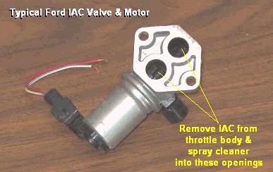

Clean out the idle air control valve and see what happens

Where is it located?

Its on the throttle body it looks like below:

Thanks again. I so appreciate your help! :-)
